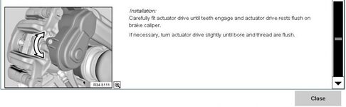

The official way to release the EPB... Not sure what you intend to do though, as there is obviously a serious (in the cars view) fault that is unlikely to clear just by removal. You need access to a decent OBD Diag/Coding system like the Delphi VCI which allows diags, operation and coding.
Anyway, as you wanted to know:
Remove the actuators from both sides, fairly easy to do...
This then allows you to access the back of the caliper, take note of the warning though!:
As per my post and Gaz's post you either need diagnostics to remove the brake or to remove the back wheels and manually remove the brake. This is the only way. There is no release inside the car, it's a manual spindle release at the wheels.
There is no point in dismantling the centre console, if you have a check control message and a locked out parking brake. If the switch was at fault, it would simply not work, it is unlikely to throw an error. If you have access to an advanced diagnostic system, you could override the error, clear the fault codes and reset the EPB. You could then run through the full maintenance process to unwind and reengage the EPB actuators.
