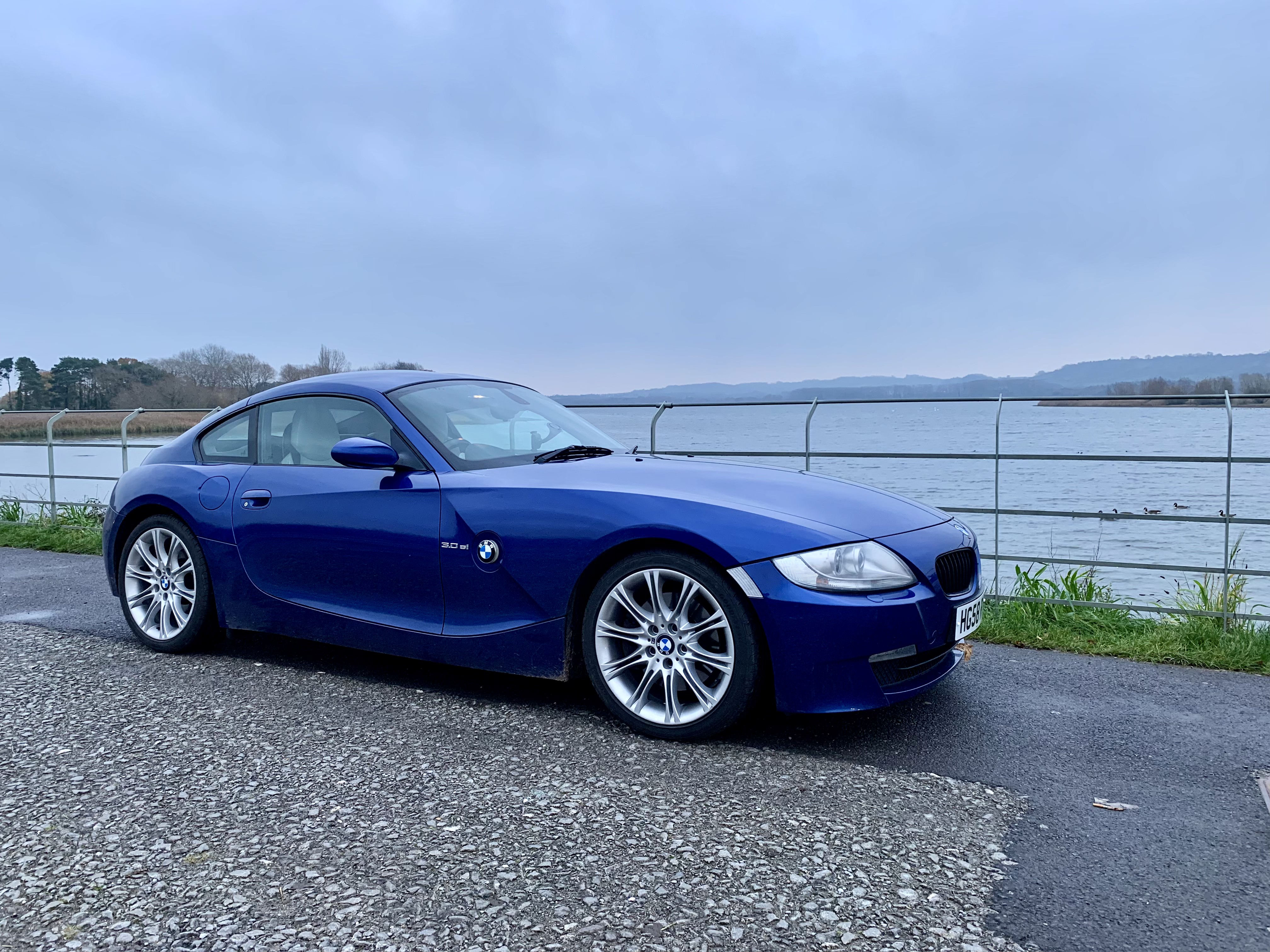

Good news all - the car is back on the road!
I decided to listen to a few of you and take the plunge to replace the expansion tank. Ordered a new OEM one (about £75 on eBay from a BMW dealer) plus some coolant, and enlisted the help of a couple of family members who are a little more mechanically minded than me.
Parts turned up last week, and managed to get it sorted on Saturday afternoon. Took us around 4 hours in the end, lots of fiddly bits - but I think the leak is sorted.
Nice feeling of satisfaction in sorting something out yourself, but I think that’s probably my limit in terms of mechanical ability!!
Anyway - have completely refreshed the coolant, and gone for a couple of runs in the car now. Yesterday was a 40 min drive whilst giving it some beans once warmed up, and so far so good! Even able to stop next to a lake for a quick photo op!
