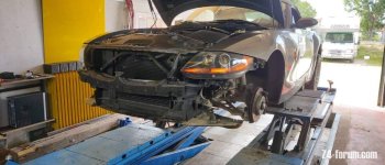

Hi everyone,
i am Luka from Slovenia and i already own bwm f31 325d, now i got a good deal on Z4 2005 2.2 so i bought it. Car was without keys so first we sorted this and made 2 new keys with remote. When we managed to do this we started the car it was running on 4cyl so we changed 2 ignition coils and now all 6 cyl are working. Front bumper is damaged and it will be repaired and painted, also side fender has a dent and will be fixed without painting. Car is sitting on 18" alpina rims, front tyres are 225 40 18 and rear are 255 35 18. Interior is in beige color and is in good condition (big dash trim with look of wood has a crack and i need to fix it), roof also needs repairing. It opens only 1 cm, despite i can hear the motor running when button is pressed the roof is not moving. Car has 120.000km.
I already see this is a great community and i managed to find many useful informations.

Welcome aboard.
Great project you've taken on.
Your roof issue sounds very much as though the roof motor in the back has got wet and died.
There are dozens of threads on here about moving it into the boot, which would be your first step anyway. You may well then be able to revive it.
Bit far to come and help, but always ask here first as there are quite a few of us who have done this job already and can offer advice.
Good luck.
