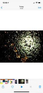

Spark plugs (see image and video - I think all is good here as soot is good and no sign of oil on the old ones)

I agree there plenty of crap behind that filter and the plugs look good, hope temperatures don’t drop below freezing if there’s antifreeze in there.
