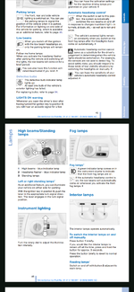

And here's a US manual - it doesn't include the levelling wheel - just the dash brightness one. Please accept my apologies - I had no idea this was a thing!
