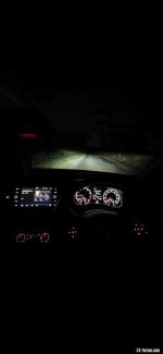

This is my beam pattern and output using LED bulbs only.
what LEDS are those. They may be great as high beams
These are them, they are no bigger than a normal H7 Bulb so they will fit in any housing that accommodates these.
I have them in dip and main and can't moan to be honest. Lasted a while now, I also will run these with my HID kit.
https://www.amazon.co.uk/dp/B07C159R21/ref=dp_prsubs_2
