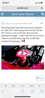

Looks like poor design from where I am sitting. No car should do that. You might expect a damaged tyre, wheel or shock after a vertical impact and yes the top mount might fail but that should be a replaceable part. Are there other makes of car documented with this issue?
The follow up vid is worth watching. A tech talks through the construction of the subframe/strut assembly in that area and why different materials behave differently under sudden impact load. Steel stretches, aluminium alloys fracture, carbon can break internally. All sounds pretty reasonable to me, as does the estimated repair cost/time of £5k and two weeks. I can believe that a lot of people are driving around in bent steel chassis from the number of alignment results you see that don't quite seem right! He also points out that the strut tower damage was likely secondary to a smaller, initial break around one of the bolts (which is much more common, hence reinforcement rings etc on many motorsports/aftermarket top mounts).

Wheel buckled and a top strut nut that started to punch through the tower (the equivalent of which on a steel chassis would be a bent strut tower). Doesn’t that constitute “something else going first”?

I think the problem relates to the choice of construction material. Porsche have accepted the lesser mechanical properties of aluminium compared with steel as a trade off for its lightness. Perhaps they should have made the strut towers from steel and the non-structural panels from aluminium :scratchhead:
