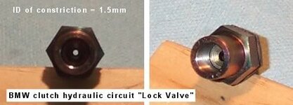

I've seen plenty of standard and modified CDV's and the only difference I've seen is the bore inside. There is no mechanism or parts. The way it works is to slow up the release bearing return by forcing the fluid through a restricted opening so that no matter how fiercly you drop the clutch, the mechanism will engage in its own sweet time once it gets the fluid back through the tiny restrictor.
If you don't want metal shavings in the system then clean them out before you fit it. Blow through it with an airline or something.
