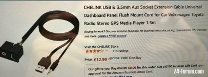

• Having run the ‘pull through’ through from the boot it dawned on me that I could now mount USB and Aux sockets in the car. I purchased a combined VW USB/AUX from Amazon (see photo) and fitted this neatly in the ‘oddment tray’. Simple to cut hole with a dremmel. Plugs straight into Grom supplied Aux/USB add on harness. This allows me to charge my phone if I need to, which can conveniently sit in a net pocket mounted on carpet behind passenger seat. I can also plug in an old ipod shuffle into aux socket.
