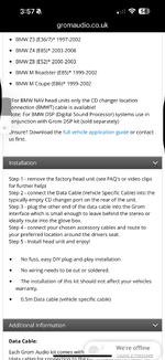

Hi everyone,
I’m a bit of a newbie trying to install a GROM BT‑3 (CD-PREP-wide) on my 2004 Z4 3.0 L (E85) and I’ve hit a snag:
It’s the plastic mould plug into Grom. I’ve noticed there’s a small noise filter in the kit (not sure if that matters).
I’d really appreciate any advice or tips from anyone who’s done this before.
Feel so close yet so far!!
Thanks a lot
Jason
- I’ve got the 3-pin CD-PREP connector in the boot.
- I’ve plugged the BT‑3 3-pin connector into it.
- Bluetooth pairs and track info shows on the stereo, so the data side seems fine.
- No audio at all.
Thanks a lot
Jason
