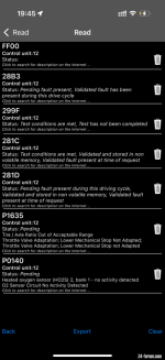

Most of the time, it threw the following code:
P1635: Tire / Axle Ratio Out of Acceptable Range
Throttle Valve Adaptation; Lower Mechanical Stop Not Adapted

2796, 281C, 2806, 281D, 2806, 28B3
(Almost all with “Pending fault present, Validated fault has been present during this drive cycle” status”)
