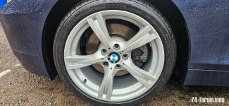

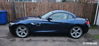

Varixto said:Thanks for your reply. I feel tempted to go aftermarket, as you suggest...the only reason for sticking to BMW alloys is because if possible, I would like to keep the car as OEM-looking as possible. Member MrTidy replied earlier something about another member using 4 x 18" 225 fronts (ie: 8J all around). Maybe this could be an option? (it would be more expensive though...).sars said:One of the other benefits of a square set up is less road noise, especially as you sit quite close to the rear tyres. [ref]Varixto[/ref], I also had the square 225R17 set up and upgraded to a set of BBS alloys 225R18 with Goodyear F1's, go for it.
225 is a 19” wheel with the wrong offset…you’ll need 10mm spacers to make them fit appropriately
https://www.alloywheelsdirect.net/bmw_alloy_wheels/3_series_e93_alloys/19_bmw_225m_wheel_1059
