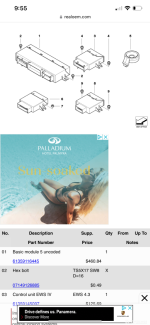

I’m trying to get to the bottom of Steve’s roof issue
We took the gm5 out for repair (usual eBay route) but it’s been returned as it’s a 12 star version
I’m confused as I didn’t think an 04 car would have that type of gm5
Gm5 for the car according to realoem is this:
I think I’ve asked before but what is unique between the gm5 and the car- I am sure you can’t swap units between cars as they need coding but is that just for the EWS/keys/central locking?
