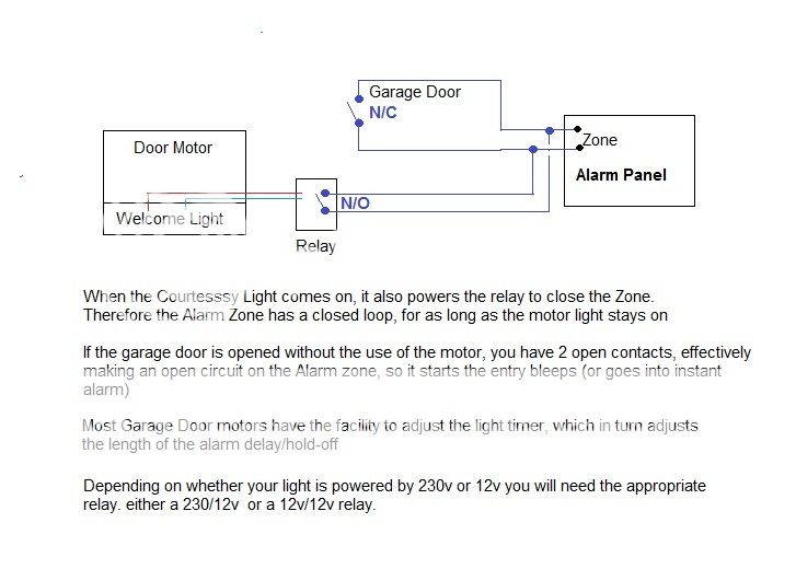

If you fit a relay to the Door opener it will shunt the zone shut whenever the motor is in operation, yet will still alarm if the door is forced opened without using the remote/motor
My door opener triggers a light on the motor unit that stays on for 3 minutes after the door opens/closes. The relay triggers as soon as the motor kicks in and also shunts the alarm circuit closed, even though the door contact is opening. This gives you 3 minutes to drive in, park exit the car and then disarm the Alarm, using a keypad in the garage (or house).
I can draw you a wiring diagram later if you're proficient and it helps ?
Sounds like a better way than mine is set up, I'd be up for a peek at that diagram!

I've drawn it out but it's on the PC at work and i forgot to post it before I left I'll see if I can remotely log in and send it home !
