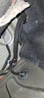

But I am unable for find the module at all. Checked the entire trunk area. Right side behind the wheel arch should be the location, but nothing there.
Picture below is from the ISTA documentation. There is a cable coming out of the fuel tank (?) and running to the module. Module is for sure not there.
Real cable. Enters the wire harness, which looks very original to me.
So where is the EKPS / Fuel pump control module?
