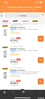

But when we looked at an equivalent part that matched the part number, eg: https://www.buycarparts.co.uk/suplex/8675144 then they didn't think the fitment looked right. The garage is saying that the correct springs have an end coil that goes "flat" on it's final half.. (bearing mind I have not seen the actual spring) they drew me a diagram which I have tried to replicate attached ..
Does this shape of spring look familiar to anyone and has anyone ordered the part aboe (or equiv) and can confirm that this is the correct one.

You have Msport suspension. If you go the Suplex spring web site and pick one that says “for cars with sports suspension” then you’ll be good.
It’s possible the springs you already have fitted are the wrong ones.
If you want to raise the car by 15mm you can fit standard springs and they will fit.
Pictures on internet parts suppliers are not always of the actual part you will receive.
It’s worth using aVIN checker to see what you car was actually delivered with.

Thank you .... maybe it's me (probably is lol) but I am still a bit confused .. the parts site list two types .. "for vehicles with sports suspension" and "for vehicles with M-Technology", is that literally the same thing in this case (but just different manufacturer's ways of describing it)?

Hello, have a look at this thread, it suggests the Suplex part you mention is correct...
Thank you for the link. Yes this seems to be the same thing ... I'm going to take these links and go back into the garage this morning and try to convince them to order those even though the pic looks different from what they are seeing ...... lol

I can confirm (I’m sure mine has sports suspension as it’s lower than the 2.2) that the springs do indeed look a bit like your drawing
A pronounced v toward the end of the lowest coil
Interestingly my car on real oem gives no spring catalogue numbers
On autodoc these are showing
Swapped the front struts on wifey's 2.5i last weekend. I was surprised to see that whilst the top end of the springs are circular, the bottom seems to follow a kind of squashed triangle shape on the strut mount. All goes together fine but if I'd not just taken them off the car I would have doubted they were the correct ones tbh.

You have sports suspension like i said. Cars with M technology are the M cars.
Thank you everyone - especially those who managed to decipher my diagram lol .. I have now ordered Suplex 06248 (x2) and hopefully they will be with me by the end of next week to drop into the garage for fitting.
