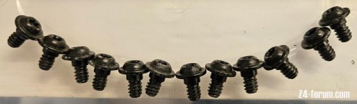

Is this the screw in question:
That bolt is doing specific job so you can't use a bigger one or a different type of bolt. It's designed to screw in tight but not crush the plastic lip of the fabric roof.

When I stripped the roof I kept all the screws and fixings for the fabric top and headlining seperate in a tub.
There are 12 of the screws you provided a photo for:

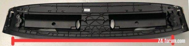

Those 12 go here:
Thanks for confirming the screw type!
The question is where can I get more of the screws and what is the part number? I can't find it on Real OEM. The previous installer must have lost several of the screws because he replaced about 6 of them with completely wrong type screws.

How many screws do you want? If you cover postage I'll send you some.
I just found a top frame on US Ebay for $85 in great shape... I just bought it. How crazy is that??
Wow, that is very generous of you!! Would you mind sending all 12 of those screws? I'm more than happy to pay for shipping. I'll DM you.

You can have all 12. Up to 100g is £4.20 standard postal. If you want tracked it's £10.60.
