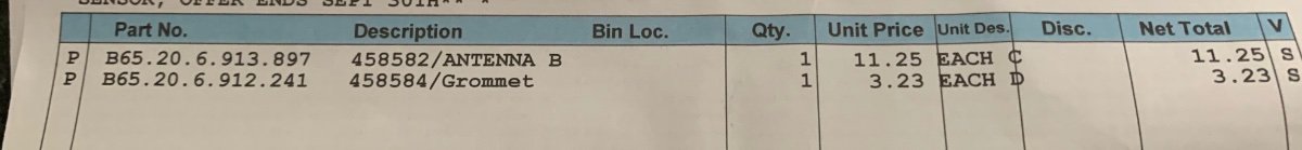

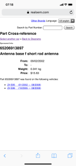

Buy a new base from the main dealers.
Parts 2 & 3 on the diagram. You might not need part 3 but I replaced it anyway.
