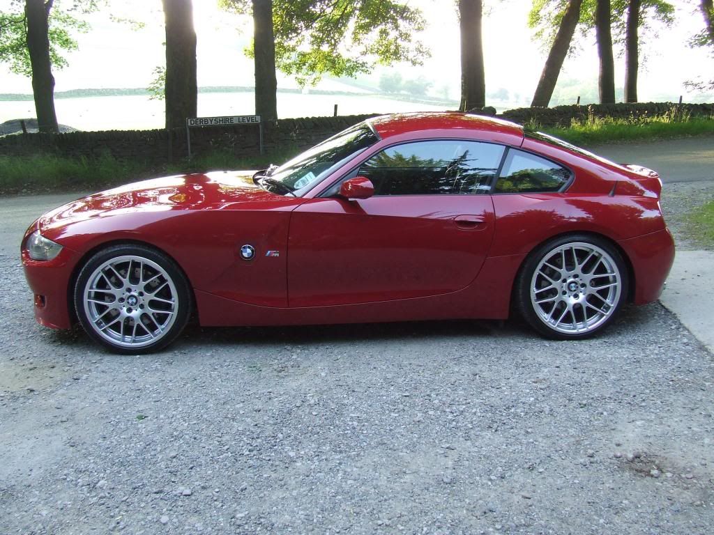

Z4M roady on H&R
3.0si coupe on Eibachs
Z4M coupe on H&R

Thanks for the feedback and images... Must say they all look nice, what offset did you have on them?
That grey Z is pretty much how I want mine to look :o
