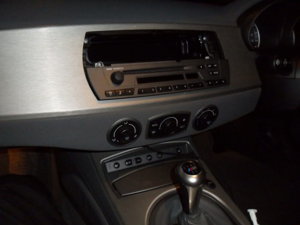

First off you need to remove the central air vent.
You need to push the metal clip in the vent on each side downwards then gently prise the vent out.
Once out it will look like this:-
Now all you need to do is undo the 2 screws which hold the head unit it, then carefully pull it forwards.

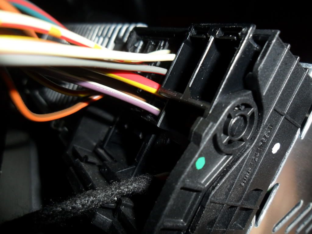

Then you need to plug your cable in the socket at the back on the leftside:-
Now you need to thread the new cable through to where you want to fit the plug end and replace the head unit.
