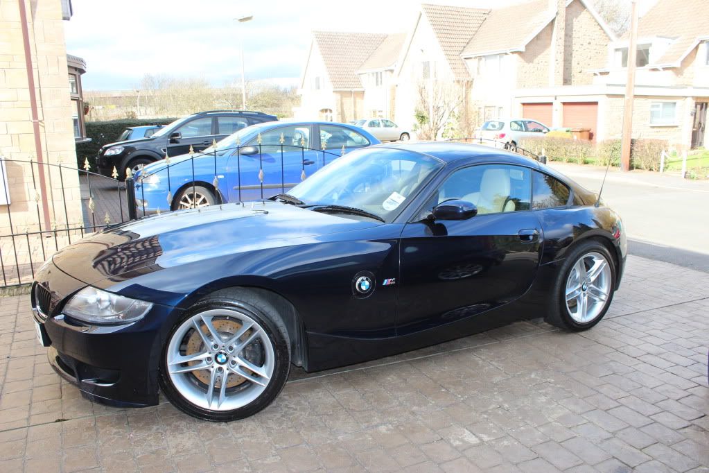

Bought a G220 a month or so ago and hadn't used on the Zed until yesterday.
A day off work coupled with nice weather = a chance to do a bit of a mini-detail. I didn't aim for full paint correction this time. It was more to get to know the DA polisher and get used to using it.
Process was:-
Rinse
Wash two bucket method with Megs Hyperwash and Megs wash mitt
Rinse
Dry
Clay with Megs clay and QD
Wash two bucket method as before
Rinse
Dry
Polish with Menzerna PO2S on orange Menzerna pad and Menzerna Super Finish on Sonus SFX Finishing pad.
Waxed with FinishKare #2685 (using a sample I had from cleanyourcar.co.uk)
Used Autoglym Wheel Seal (using up an old can) on wheels and Megs Gold Class tyre dressing.
BMW Glass cleaner on windows.
Ran out of time to do Autosol on exhausts or the interior. Will do the interior this week.

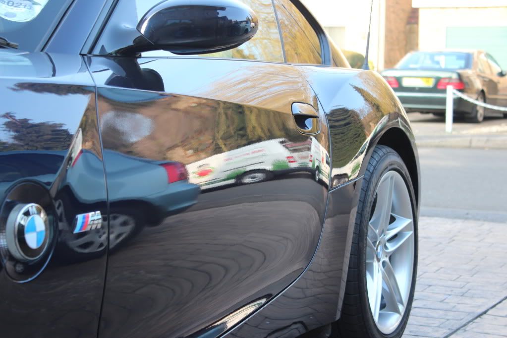

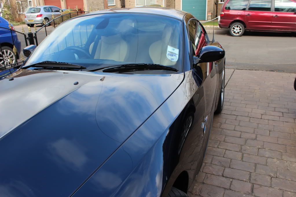

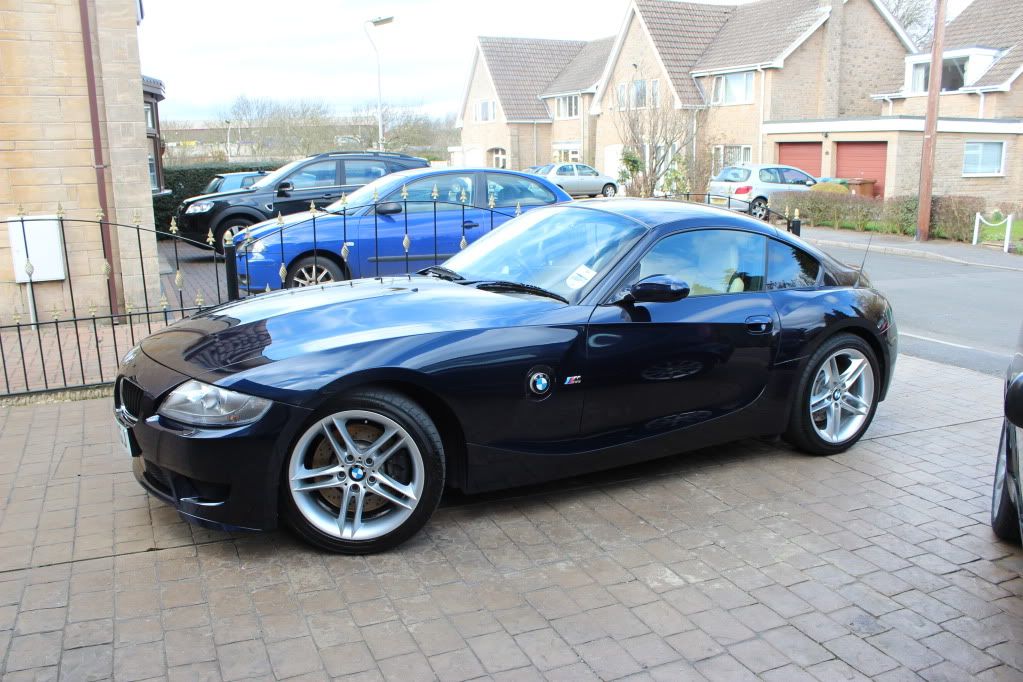

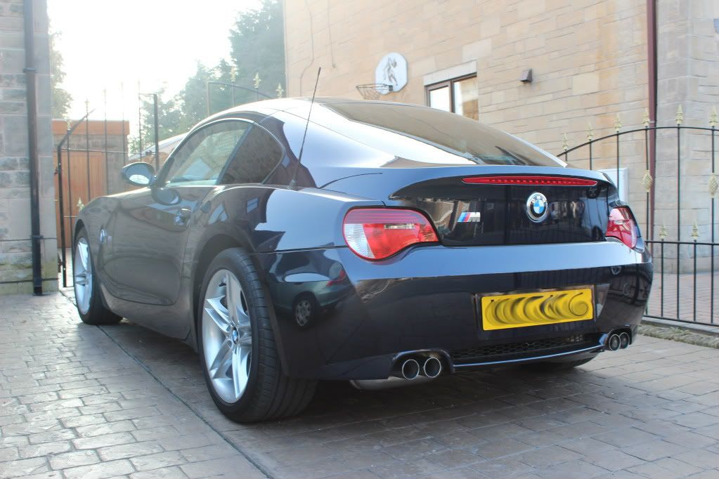

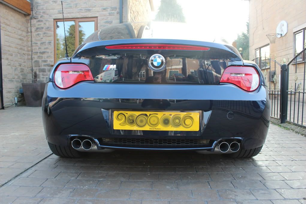

A few photos of the finished result.
Thanks for the comments guys :thumbsup: Few more photos added - this is 24 hours after being washed.
You'll notice the lovely BMW 'orange peel' effect in one of them. Nevertheless I'm really pleased with the polisher.
Next task is to get the front bumper resprayed to get rid of all the stone-chips.
There's a few waterspot marks on this one....and check out the orange peel !
You forgot to blank the front plate and dry discs. Looks pretty clean though, what colour is it?
Ah the bloody discs! If I take the car for a quick run the rust on the discs streaks all over the bloody wheels so I have to clean them again! :headbang: So I leave them to dry and the first time I brake it removes the rust without staining the wheels. I've tried drying them with a towel, doesn't seem to work as well.
It's the same colour as yours VvrooomM. :thumbsup:
