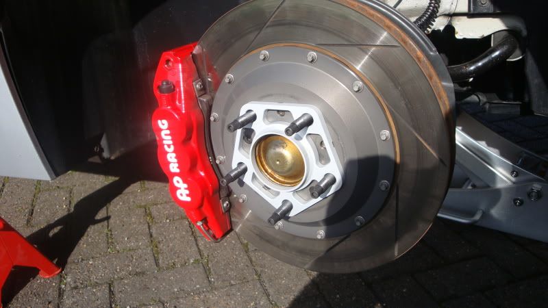

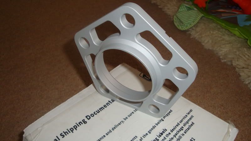

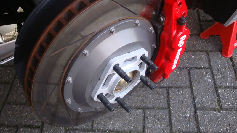

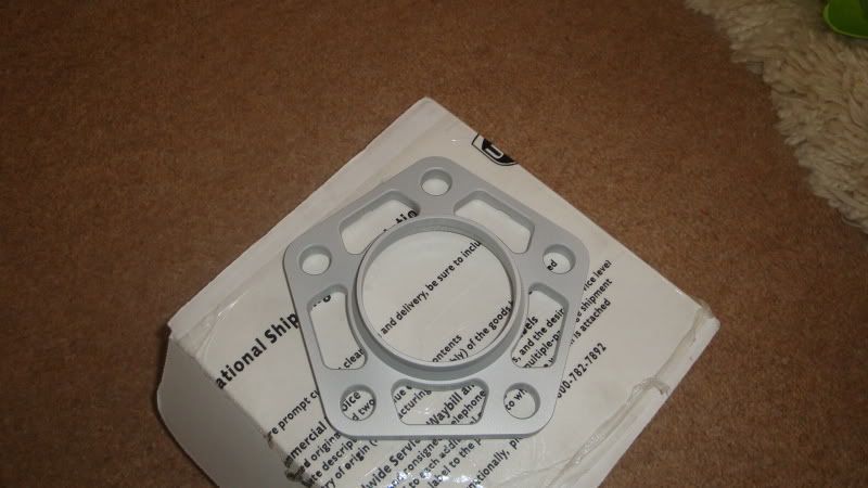

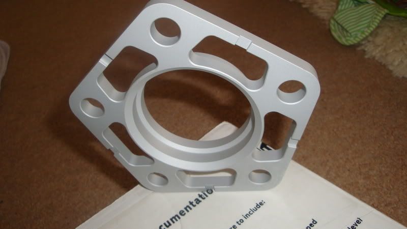

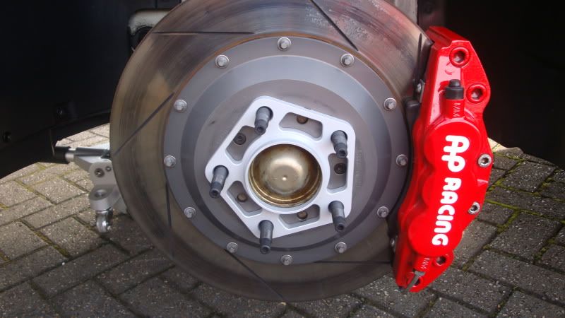

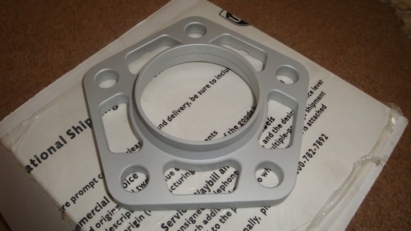

so i installed these new verstrasse ultralight-weight spacers and im literally blown away by their quality, these are 10mm spacers and compared to my Eibach 12mm spacers were talking LESS than a quarter of the weight, infact i couldnt get my scales to get a number on these!! very very pleased with them!! The reason im swapping to a 10m spacer is on my et32 upfront under Super extreme conditions at the track i can just and i mean JUST glance the inner plastic fender, as this is unacceptable to me i dropped the 12mm spacer to a 10mm to get an ET34, looks identical to the eye but will stop this happening, also its nice to have spacers that weight literally nothing, like a few sheets of paper light.... The quality is nothing short of perfect either, BMW Motorsport in the GT division use these pentagon shaped units, they lose ALOT of material!! This car goes back to simpson to have the winter parts stockpile installed that i cant install...... more on that shortly :-)

new pieces
installed
wheel clearance is alittle tight for my liking but ok... will need to keep an eye on this....
