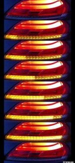

Well, that was another interesting project in the past, when I reworked my backlight clusters to "Dynamic Winkers" with a dozen of selectable light sequences. :rofl:
Different attempts to get the clusters carefully opened...

Summary:
Not an easy job, very time consuming with big risks to destroy more than before. Not worth regarding the current price of about 200€ for a new cluster.
I’ll try the glueing strategy on my old pair that cracked šŸ‘Œ
Good luck. But get it completely dried before starting.
Already existing corrosion can't be repaired in any way. And keep care on re-mounting it. The seals have to be carefully pulled into the trunk before fixing the 2 or 3 nuts.
