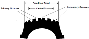

Tyres are covered in section 5.2.3 of the MOT manual.
The primary grooves of the tread pattern must be at least 1.6mm deep within the central three-quarters of the breadth of tread and around the entire outer circumference of the tyre (see diagram 1).
Either side of the central three-quarters of the tyre can be devoid of tread (‘bald’).
Diagram 1. Primary and secondary grooves in tyre tread pattern

This is why IMO it failed as per the provided link - amongst many others, the tread additionally needs to be visible across the whole surface
The tread pattern must be visible over the whole tread area (see diagram 2), and have a depth of at least 1.0mm throughout a single band of at least three-quarters over any section of the breadth of tread round the entire outer circumference of the tyre
If you consider the main contact point on a turn is on a bald part, that’d be like driving slicks in the wet - better safe than an expensive sorry :thumbsup:
Two issues here, I do realise that I'm late to the party here though and it's irrelevant but here goes.
Do the tyres need replacing yes 100% without a shadow of doubt, most organisations recommend replacement at 3mm for good reason.
Should they have failed MOT, well based on the photograph no they should not "At least 1.6mm throughout a continuous band in the centre 3/4 of the tread and around the entire circumference" is the wording and the current tyre law in the UK.
There is no requirement for the tread outside of the central 3/4 as outside of the main water evacuation channels some features of the tyre will be designed to wear out quicker than the main tread pattern.
So the OP was correct in my opinion and the tyres aren't technically illegal, he has however done the correct thing by replacing them :thumbsup:
