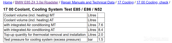

Anyone know how much coolant/antifreeze is required once it’s been drained? 4 litres be enough?
I would get yourself 5 litres of concentrate.
Lovely, thanks 💪

Also, where did you get this information from?
