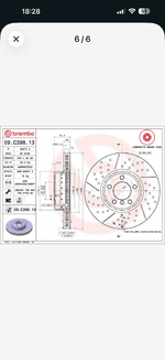

However,I ran into trouble as I didn’t buy the 340mm F20 discs. I thought the 35iS 340mm would be fine! They are not. So you definitely need to have the correct discs or the pads interfere on the hub hat and they are too big for the disc surface. Live and learn.
Well all done and brake bleed procedure complete. Ran 10 x 60 to 10mph heat cycles. They just need to bed in properly for the right pedal feel.
Discs I went with Brembo. Discs
