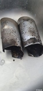

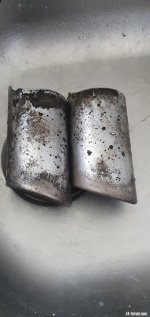

So I have had a go at trying to remove the tips in anticipation of the new ones coming in a few days.
The old ones are not budging, not a bit. I appreciate they have been stuck on for 15 years but reading threads on here it appeared to be a simple job. Ive lubricated, inside (from the back), small hammer and wood. Not moving. Im afraid to go gung ho at it. So any other ideas?
I recently helped someone get their E89 tips off and it did require some heavy hitting to get them started.
Hitting at the back? there is little room to get a good smack
I've actually manged to get one off. Bit more force and longer piece of wood. Other one is harder though as difficult to get the wood on something

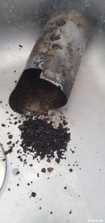

Yeah all done. left one was harder to get at so had to resort to a chisel to hit with a hammer at one area that I could get at with the right angle.
They look worst for wear tbh as expected
Also the amount of stuff that came out of the second one was amazing, looks like tarmac!

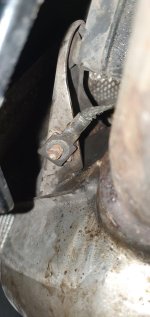

Also whist doing it I noticed an earth strap loose above the exhaust behind the bumper. Looks like nut has disappeared. I put the strap back on just looking for a suitable nut to secure it.
Is this strap a vital thing?
Bombur said:
Also whist doing it I noticed an earth strap loose above the exhaust behind the bumper. Looks like bolt has disappeared. I put the strap back on just looking for a suitable bolt to secure it.
Yes it is..
Yes it is..
[/quote]
An earth strap?
Any idea what size nut, couldn't find it on realoem- tho only had a quick look. Is it M8?
One assumes helps to ground exhaust for the O2 sensors.
