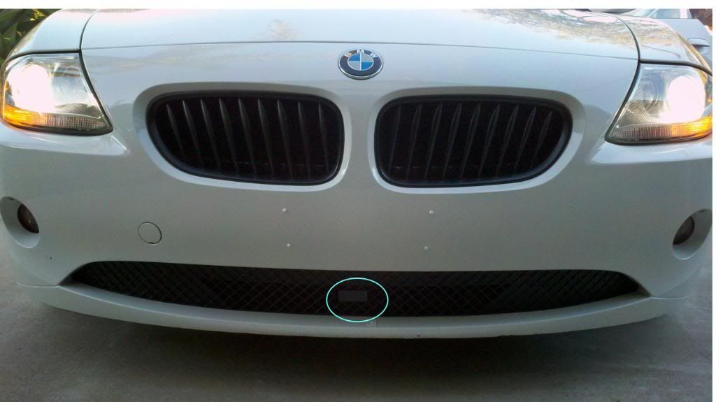

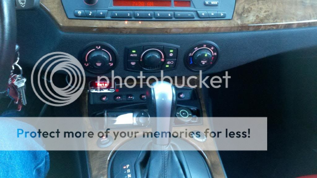

Installation has now been completed. Attached are a couple of pictures to show the receiver mounted in the lower front grill, and the LED display installed in the interior.
The task was not too bad - a single wire to run through the firewall. Power was connected directly into a switched circuit at the fuse box (behind glove box). The controller module (receiver input, display output, and audio) was mounted behind panel below the radio.
Installation took about 6 hours, total - a far cry from the advertised 45 minutes for a "typical" installation, but I'm pretty happy with the results.
