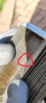

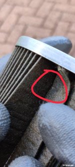

The oil sample results are all clear which gives me hope the knocking sound isn't bottom end related though Redish say you can't be sure... https://youtu.be/QNVJwh-3o58 Redish are saying you need 7 - 20 hours to investigate top and bottom end. Seems OTT at this stage surely
Attached is a photo as well of a small bit of swarf (~2mm) from the old oil filter that I replaced.. otherwise all the other flanges of the filter were clear (only small dots of stuff elsewhere). Shine is the oil in the sun, not metal. Can see a picture in the shade for comparison
