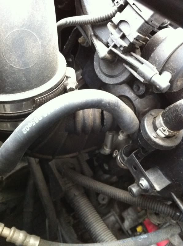

Mine was making a similar noise - turned out to be:-
