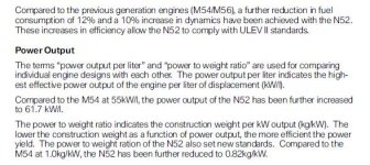

I have a N52 training manual that shows the changes brought about by the N52. If anyone would like it, let me know.
For example, there were power output changes:
I have that information also, but it doesn’t relate to the black top n52 & was describing the silver top earlier version relative to the m54, I’d like to see something official describing different outputs of the early & late n52 :?
