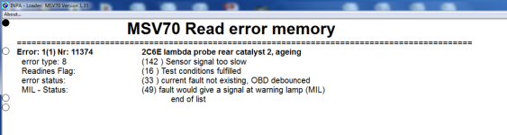

By using INPA (and a child) I've got the following error code
Looking in the error history I see this had happened three or four times before - the same code 'signal too slow' but not during my ownership (eighteen months so far). I'm assuming that fault this is going to come back and I will need to change the sensor soon. So is it expensive and difficult to get at? - says rear CAT so I hope not.
The car is a 57 plate on just over 44K. As I've not seen this error before do you think an aging sensor has been changed in the past? How frequently do they need replacing. No short runs in the car; being out in the sticks its all warmed through before you get anywhere not like start stop urban driving.

Hi, seems a low mileage for lambdas Harry-you could try some cataclean product first and see if it stops the issue?

Look like an after cat one, bigger job that the pre cat to replace. Worth trying some cleaning stuff as these sensors aren't subject to the same heat etc as the pre cat ones so don't often fail. Cleaning contacts can also not hurt. Failing that, I'd be tempted to drop the exhaust, replace the gaskets and bolts and do both sensors.

Try changing the fuel both where you buy & octane , don't be afraid to mix 95, 98 & 99ron in one tank & then try a decent heat cycle of 45mins - hr not pottering :oops:
I had the same light shortly after buying latest ZM , kept resetting then it would re-appear a day or so later , it had been on constant for 2 weeks then heading off for a weekend away i had half a tank of 99Momentum in then brimmed it with 95 ( yea i'm not one of those fuel snobs :o it says on filler flap 95-98Ron so that's what it gets )
Within 100 miles it had reset itself & not returned as yet ( 400 miles later) at no time did the car run any different
