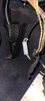

Because I bought RHD EPS motors for a LHD car, I had to switch the 2 sensor wires:
I decided to add a connector. For future myself or anyone working on the car, it is completely clear something fishy is going on here. Tomorrow I will add a label to point out the 2 wires were swapped and need to be "unswapped" for a LHD EPS motor in the future. Unswap = pins out of connector, swap and back in.

This works like a charm. Thank you for the warning. That could have ended bad.

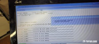

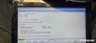

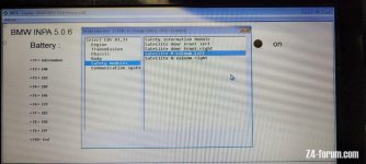

I removed the driver's seat to work easier under the steering wheel. Had to start the car to test the EPS and ended up with a "Airbag Warning Light".
Had that before, but forgot how to solve. INPA photos below show that the error is in the SBSL (Satellite B pillar left).

Clear the error memory and light goes out (assuming you did not brick anything for real).
