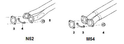

I was thinking about this for my 3.0si so did a little research.JamieZ4C said:Would this system fit a N52/3.0si? Or is it M54 only?
Short answer: it won't fit N52.
Long answer:
N52 exhaust manifold to mid-pipe flanges are aligned in a 'V' shape:
http://www.realoem.com/bmw/enUS/showparts?id=DU53-USA-10-2007-E86-BMW-Z4_30si&diagId=18_0653
M54 exhaust manifold to mid-pipe flanges are parallel:
http://www.realoem.com/bmw/enUS/showparts?id=BT53-USA-11-2005-E85-BMW-Z4_30i&diagId=18_0498
The eBay advert clearly shows parallel flanges:
