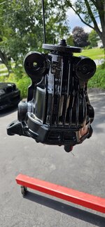

M Muleman750 Member Newyork Sunday at 1:16 AM #1 Doing a seems legit garage ford 8.8 differential swap. I have to run e46 330i or e46 m3 rear trailing arms. Any way to delete or code out the electric parking brake?; Or maybe retro fit it?
