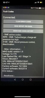

I was getting 30FE (Boost pressure control, boost pressure too high) and 3100 (Boost pressure control, shutdown).
Interesting it could be WG controller solenoids. I'll see if the codes come back after I've finished fitting the FMIC and chargepipe and have a chance to give it a decent run. Thanks for the tip.
Edit: I would have thought that faulty solenoids would cause a 30FF (underboost) code as they're not building pressure? (or holding pressure, sorry if I'm not 100% technically accurate).
I had the exact same issue (30FE and 3100) and MHD themselves advised I change the solenoids. Since then I never had any issues. From what I've read, faulty solenoids can cause both 30FF and 30FE (under and over boost). Let me know how it goes, I'm curious what caused you the issue.
Best,
It depends how the logs look as to whether the fault is related to the boost solenoids. It's quite possible that the overboost codes are entirely tune related as the MHD OTS maps aren't perfect.
Agreed - people had overboost issues with the 8.1 maps. Try the latest 9 maps if you can! :driving:
