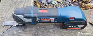

Don't even attempt without one of these:

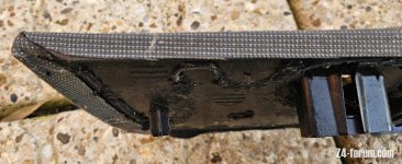

You'll also need a big flat bladed screwdriver. Once cut, where possible, you have to crack the welds apart again because of the heat from the cutting tool slightly welds them back together again. The rectangle section where the airbag would go has to be cracked apart with only the screwdriver as you can't cut it. You have to be brutal. It feels like you will break something you need but luckily the bits you need are stronger than the welds.
I did the second door card in around 20 mins. The first took a lot longer.

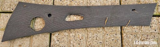

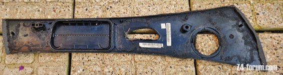

This is what the panels look like removed:
That’s really useful thanks. The multitool is a good shout, used a dremel with a cutter last time but I’m sure that will be tidier.
I’m going to have a go at seeing what I can retrieve off the e89 door cards and see what’s useable in terms of the alcantara.
Also consider I could send you those panels that I've removed and are wrapped in cloth. You can then wrap those instead with the trim from the E89 door cards to see if you get the results you're happy with before going further.
