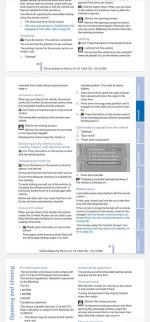

I have a smart top installed now - is the procedure the same as if I had comfort access?
