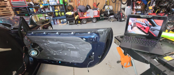

So, the door panel and sound shroud are off. I figured out the puzzle box combo to remove the outside door handle. (crazy)... I have removed the entire wire harness, except for the run that goes to the outside handle...
I'm stuck there for the night until I mull it over some more. With a borescope, I can see that the wire that runs to the outside handle is attached to the outside of the door. I'm trying to discover a way to remove that and replace it with the CA door wire harness without removing the window.
I'll take more pictures to improve the view -- but putting it to bed this evening.

I will remove the H-brace when I get time this week and see if it gives me the space to reach up and access those wire harness attachment points. The window is currently up, which may help get it out of the way. Removing the window will be a real :headbang: if it turns out that's the required step. I could yank and pull, but I need to be able to get the replacement secured so it doesn't impact the window operation. And if I'm lucky, resell the existing wire harness for the same $$ on Ebay.
The outside handle was amazingly easy to remove once I understood the concept and could see the hook point with the borescope. Thankfully the carrier is the same for both CA and non-CA, so I won't have to mess with all of those physical locking attachments.
