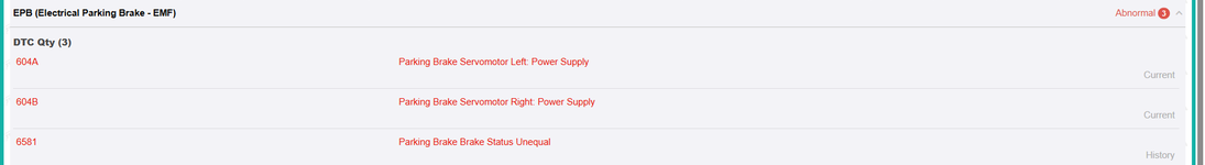

As I had not used the car for a couple of weeks I decided to take it for a spin today. I got greeted by the dreaded parking brake yellow warning light on the dash.
I scanned for errors and got loads. I suspected low battery votage and indeed, it was only 12.1V.
(note: I noticed that I had left the lights switch on but it should not matter, should it?)
The car's parking brake button was not lighting and seemed inoperative but I managed somehow to relase the rear brakes upon starting the engine (I heard the motor operating).
I took the car for a couple of long spins and now the battery is on a healthier 12.6V.
I scanned the car and most of the weird error codes were gone. However these three keep coming back.:
The battery is a Bosch one, a bit over a year or so old. The left side (nearside) PB actuator had been replaced with a BMW part a few months ago. I checked in the boot for signs of water ingress and could not see anything wrong.
I would be very grateful if anyone could give me any pointers towards what the problem might be.

Do you think it's the same issue but on the other side? (ie: the driver's side) It's the first thing I thought but I am getting fault codes for both sides...

The absence of the lamp in the switch would point to no power in that circuit, as to fuse if its blown probably due to a short in one of the actuators. Find the fuse and check it, if its blown replace with new one see if it blows again then find the failed actuator.

Fuse 52 was ok so I think that it's back to the drawing board...
Well, I thought I should post again to bring this post/thread to an end. After giving it a good run yesterday, when I went to the car this morning, I cleared the error codes and noticed the 604B had completely cleared but the 604A remained, thus the yellow warning was still on the dash.
I noticed that the battery voltage was still a bit low (although at much better charge level). I gave the car a good, long run of about an hour and parked the car. The parking brake was still inoperative so I just simply left it in gear...
Well...I went to the car again later in the afternoon, got in and suddenly...no more warning light on the dash and the parking brake is back to normal!!
I had the car already booked in at a local BMW specialist so it seems that the gods of motoring have favoured me this time... (for a change).
I think that it t was probably the low battery triggering all this. From what I have read, these cars' modules are really sensitive to low voltage levels and I am guessing that's what happened in my case.
