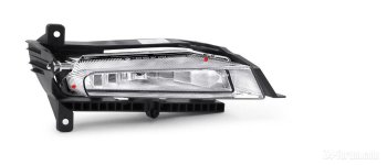

Just jack up the car, remove the wheel, so you have all the space needed:
Remove a single Torx 25 on the outside:
Two on the inside:
When opting for Magnetti Marelli's make sure you keep the tiny metal lip:
Re-mount your new light in reverse order and enjoy the difference (left = new):
Mau said:
I really would not go for the bumper removal route, also because new brackets do not come for free.
Two on the inside:
