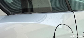

Popped out side now and took these.
What is going on with the side window seal? Looks overpainted and the rubber is lifting up.

Fantastic!
I do love a silver coupe... :thumbsup:
Having all that rust gone from inside must be a good feeling.
But yes, something funky going on along the window rubber.
And also the plastic clips on the bottom the wings are now silver, they should be black.
I can understand if they needed to repaint a 2nd time and they didn't want to remove the panels again, they should have masked up a better.
Or just charged you 2 hours more labour to remove them .(they must be a wizz at the process now)
Or maybe they creased the new paint while installing, I remember that window seal being very tight and needed to be folded over the wing.
There does look to be a touch of over spray on the rubber. I was able to rub it off, so will just need to work my way round and tidy up. As to the rubber lifting, I know the very end was always sticking up near the door, but hadn't noticed it elsewhere. Looking at the photos I am not sure if it's cause of the overspray making it look different.
Is there a sealant that normally goes under the rubber trim to hold it to the panel?

The black plastic clips that hold the outer wing panel to the bumper and sill. They're black, but easily over-sprayed if spraying panels in situ. On your pics I can just see they're silver. No issue, but a sign something has happened.

Took a closer look today at the overspray and where the rubber looks lifted. From what I can tell, the over spray is on the leading edge of the rubber strip, and therefore in the photo it looks like the rubber has lifted. The paint was able to come off the rubber easily and it does look an other better.
