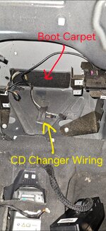

I believe I have read almost every post about bluebus, but I can't find harness to connect it.
Please someone confirm that e85 without harness existed before I disassemble cabin to get to firewall from inside.
This is picture from trunk of my car.
Nothing inside black tape (removed)
Nothing under that plastic. It is very firm, if I bend it more it will damage
And overall not that much wires there to hide something.
Car doesn't have CD changer preparation option 692
Only 648 CD radio
Head unit labeled BMW Business CD

If you can find similar wiring on the boot side behind the black taped wiring loom then you'll have cd prep.
I'm not sure all Zed's had cd prep but I know UK Zed's did. Maybe in the rest of Europe they didn't?
Thanks for that picture. I saw it before and lost :)
As I understand it - these twisted wires are going to trunk but I didnt find them inside harness
My Zed is from Switzerland (2004)
