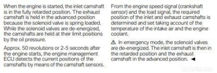

Reading this, I am wondering how the VANOS oil supply works.
Did you also try to activate the VANOS in INPA to see what happens? The error you had in ISTA almost suggests that one of the conditions for VANOS activation is not met. Does the DME throw any other fault codes?
I just looked at my collection of pdf's for the Z, and I did find some documentation around the vanos. Perhaps it helps.
