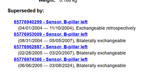

Hi. First time posting in this forum. Have a 2003 2.2 Z4. Having enjoyed this for a couple of years, using most days, I recently bought a G29/M40i to replace it. Much as I loved the E85, there's not the space on the drive, so it's got to go. I wanted to sell on with full MOT, but it failed on one item only - a seatbelt light which shows up as a code 985D: Seatbelt tensioner, short to earth. Investigation shows it's almost certainly the SBSL module, rather than wiring under the seat (fault won't clear even with relevant pins disconnected at SBSL). Does anyone have a known good replacement for sale? I'm in Somerset BA22 8TY. Removed PT no is ...6945157, but I understand several other later units may work. I understand need to set VIN and time. Also open to offers for whole car as is. Apart from the seat belt light, everything including soft top motor works as it should. Red leather upholstery, Bluetooth phone integration, 2 sets of keys and spare blade. 104k miles. Good tyres. Recent brakes all round. NI plate, so no date. Titan silver. Some bubbling on rear arches - (non structural). Regards, Dave
