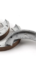

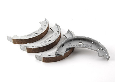

I think I may just replace the handbrake shoes and fitting kit too. Circa £200 from bmw or around £35 for ATE from AUTODOC.
Although it looks like OE bmw are jurid looking at the part image on eBay.
