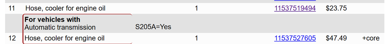

According to RealOEM, the radiator for a manual (17119071517) is shared with the E46, whereas the version for automatic (17117551635) is exclusive to the E85/86.

I'll check mine, l wonder what connects to it if there's really a connector. From realoem there's nothing connects to it.
It seem like cooled coolant return line. After further studying, the auto trans uses number 11 hose and there's no tube connect to the lower connector.
So just get a regular E46 auto trans radiator

Thanks for the replies so far, and maybe its a RHD thing, maybe a silvertop N52 thing, maybe an Auto thing. My car originally was sold in Japan, although my local BMW dealer states they've got one of these radiators in Germany.
To be clear, I had previously bought one of the generic E46/E85 radiators and having pulled my one, it definitely has the additional port. The port is best shown on this E90 forum post which is also an N52 engine (albeit a 3 series) with the same problem
I wonder what the pipe does, perhaps its not needed, as it obviously isn't used universally or was maybe discontinued. Perhaps I could run without it although Im reluctant at this stage.
