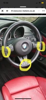

OMG Ian what a witty and gripping 'tale of woe' !! Pleased to see you solved all your problems and good to know how a change of solenoids might affect the car - it might be me next so thanks for sharing your experience. Look forward to reading your next car related exploits :)
When you refurbed your wheel is it possible to remove the sections of trim that go in between the leather too (see pics of my explanation has you confused) I’m too worried to disconnect the battery but I don’t want to remove the airbag incase it sends the screw driver into my face

Hi Gav,
Yes, you can remove the plastic spoke covers. There’s a few guides on the forum how to do it.
I’m not pretending to be an expert here though.....
I disconnected the battery and left it for an hour while I had lunch. Then used a thinnish flat blade screwdriver. You have to poke around a bit (gently) in the hole(s) on the steering wheel mount and you’ll eventually locate a spring that’s resisting you. Push against the spring and pull the centre holding the airbag forwards. It’ll pop off the mounting side by side.
You can then undo the bolt holding the wheel to the column.
The spokes are pretty fragile so be careful. Undo the four screws securing them and gently pry them apart. There’s tabs that need freeing. You’ll see them. Lots of people have found that the mounts for these screws are broken already or break when doing this. Use some epoxy resin if that’s the case.
I’m sure you’ll manage if you give it a try. And if there’s no power to the airbag and it’s capacitor is discharged it shouldn’t kill you.
Ps. I forgot. There’s some electrical connectors to free too before you can take the airbag off. Be careful of the single earthing wire. It’s quite delicate. The two small connectors in the airbag itself need to have their sides gently lifted with a tiny screwdriver to free them. The connector to the column just has a tab that needs freeing. Usual type.
