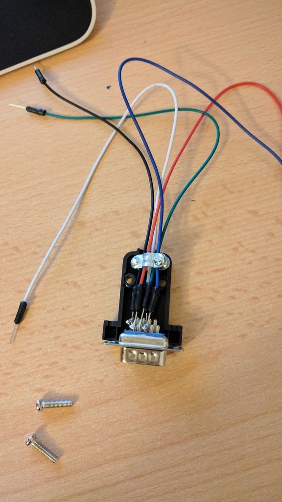

js_online said:According to wiring diagrams I used pins 5, 6, 7 are for RGB and 14, 15, 16 for corresponding grounds. Sync is not present on MK4 and is present on TV tuner only. My setup is without TV tuner. If you have setup with tv tuner you should have sync.

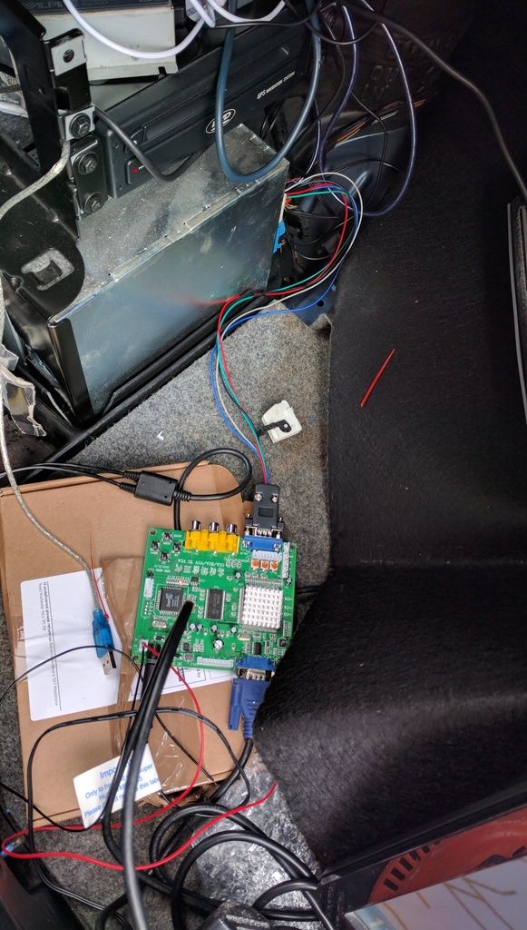

I am not sure about output result of your video board. I tried similar one but was not satisfied with results until purchased Ambery.
Thanks for the info. The board has arrived today, it was cheap so I figured I'd give it a go and see if I can get anything. I'll have a good look into the wiring tomorrow and see if I can get any results.
