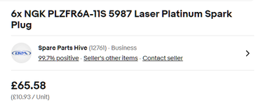

Got all this in the basket ready to purchase, only about £130 odd which seems reasonable.
